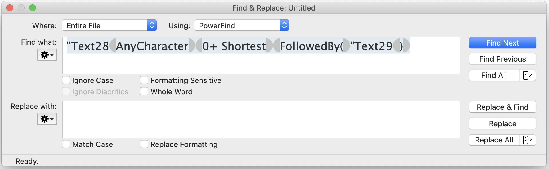

As I don't understand regex, that is really Greek to me. Can that be done with powerfind?
Again, thank you!
Re: Macro and Powerfind
Posted: 2020-09-02 21:50:38
Screen Shot 2020-09-03 at 14.45.jpg (110.13 KiB) Viewed 25482 times
Posted: 2020-09-03 00:02:03
by dougelrsystems
Thank you, the 0+Shortest was the part I didn't realize. For clarity for anyone else in the future, the attached image has the whole macro line.
