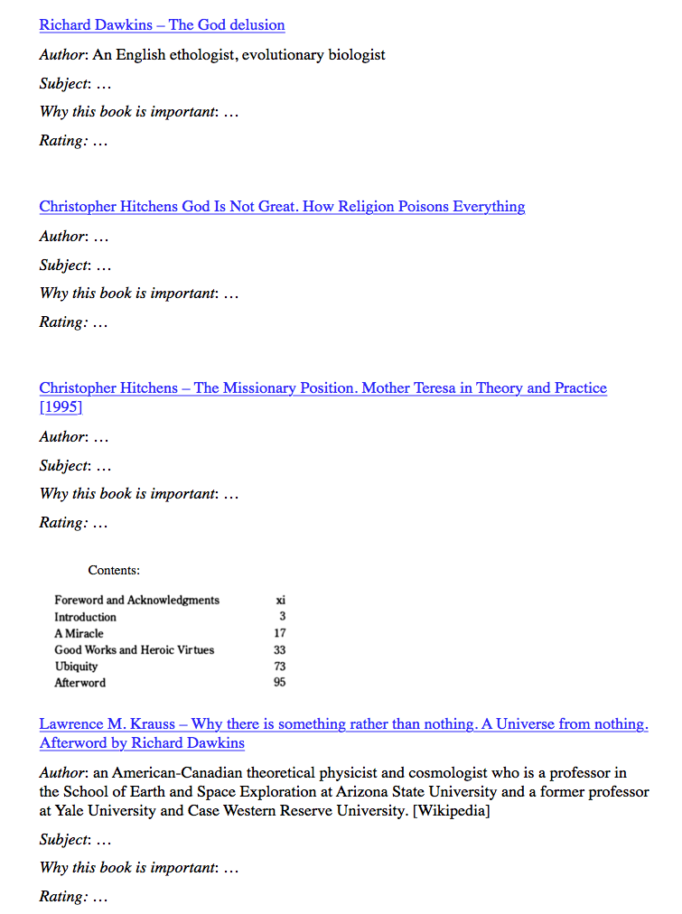

Trying to ram multiple PDFs into one Nisus document isn't a good idea. If it were possible, it would just make your Nisus document unnecessarily bloated. No need to duplicate the PDFs after you have already created direct links to them in Nisus.
I would create a link to the document (PDF) in Nisus, press the Return key and then type a glossary abbreviation to insert a pre-configured list of elements I consider important for the project.
An example:
1. Select the PDF "Richard Dawkins – The God delusion" in the Finder and press Command+ c
2. Paste into Nisus. This will give you a clickable link to the original file.
3. Hit Return and type a glossary abbreviation to get, for example:
•Author: …
•Subject: …
•Why this book is important: …
•Rating…
4. Enter all the information you find relevant
5. You can also paste a screenshot of the book's TOC.
Let's now see how this works in detail:

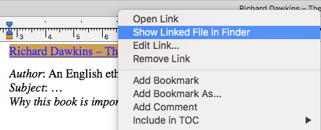

1) A simple click on the link will open the original PDF in your default PDF reader.
2) With a right-click or control-click you can show the linked file in Finder

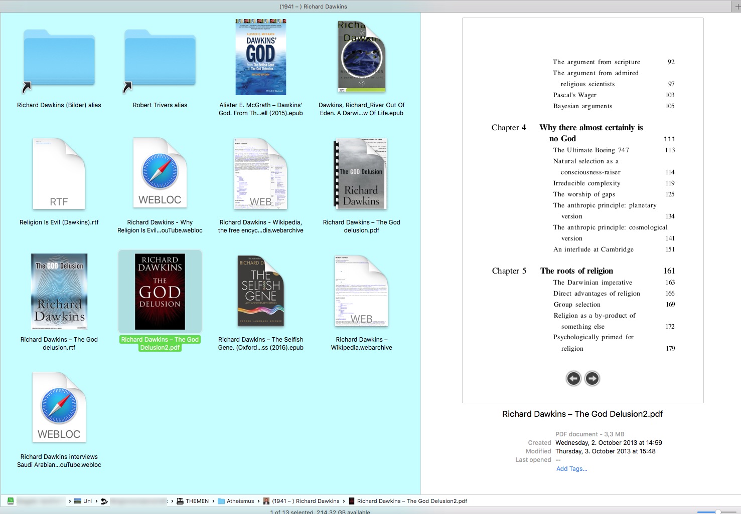

At this stage, in order to be able to see the content of the PDF, make sure the "Show Preview" in Finder is enabled! To do that, open some folder in Finder and pull down the View menu… View –> "Show Preview"
Once "Show Preview" is enabled, you can quickly skim through the whole PDF by using one of the following three methods:
1. Place the cursor in the right part of the window and scroll with the mouse wheel (very fast) or
2. click on the arrows. The arrows fade away when the insertion point is outside the right window-part.
3. Swipe up or down if you have a trackpad.
In the meantime, the Nisus document itself could look something like this:
As you can see on the screenshot, the names of the PDFs are shown in blue and underlined. If you don't like that, you can easily change it by clicking after the name (but be still on the same line), then go to the Style Sheet View. The Hyperlink character style will be already selected there for you to make any formatting changes you may wish to perform.
