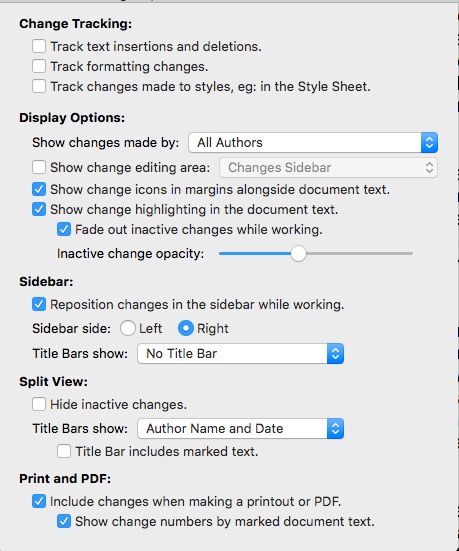

martin wrote: 2019-08-20 10:08:14 One other thing to check: do you have tracked changes enabled for your document? You might be accruing a huge amount of prior text or images, especially if you keep trying to fix your "sick" document by copy-pasting the images over and over. That could continually multiply the images in your document, further increasing its size.
I have not used that feature although it is possible that it somehow became set without my knowledge by a random key command ... (?) I am posting a screen shot of how my track changed are set now and if this looks like it is doing as you were asking after, please let me know.

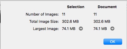

I turned on show invisibles and, if there is anyway I can learn about the problem and correct it myself, I will be happy to try out any suggestions. Mistakes are after all the best way to learn. Otherwise I will send you the file to review as you offered.

Your screenshot of the tracked changes options window shows that you do not have tracking enabled. So that's unlikely to be a problem. It's still possible your file has tracked changes that were recorded earlier, but that's unlikely, especially if you didn't turn it on.
However, your screenshot of the image analysis does indeed show a huge image. Your largest image is 74 MB (megabytes). That is huge! Much bigger than you need, no matter what kind of output you're doing. And that's just a single image. If you have many images of that size in your document, you might even near a gigabyte of data just in images. That's definitely not what you want.
If you click the little arrow icons in the Image Analysis dialog it will open a list showing all images in your document. You can click through that list to highlight and select the offending images. You should resize them externally, so they are reasonably sized.
