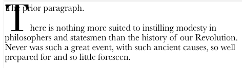

There is something you can do: switch the line spacing mode from "multiple" to "fixed". This will ensure the lines of text in the paragraph are exactly the same height, regardless of how large the letters are.
However, the result is a bit of a mess:
You can see that the large "T" draws over the prior paragraph/line because there isn't enough space for it. The solution is to increase the paragraph's spacing before, so the lines inhabit their own area on screen.
I'm attaching an example file that incorporates all of this into style definitions. The "Drop Caps Paragraph" paragraph style should be applied to any paragraphs where you'd like to add a large first letter (these are called "Drop Caps"). Meanwhile the "Drop Cap Letter" character style should be applied to the first letter to make it large.
I hope this helps.
