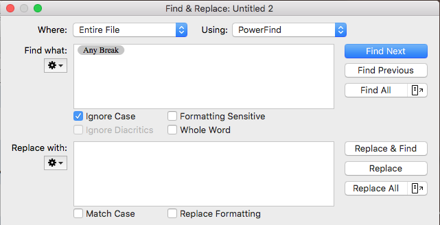

Did you try this?
Re: removing page break mid-paragraph
Posted: 2020-02-10 06:48:28
by ngazidja
Yep, no breaks...

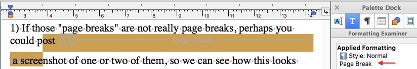

You could also try to use the Formatting Examiner palette. Select one of these breaks (or a few characters before and after it) and see what the Formatting Examiner says about the applied formatting.
