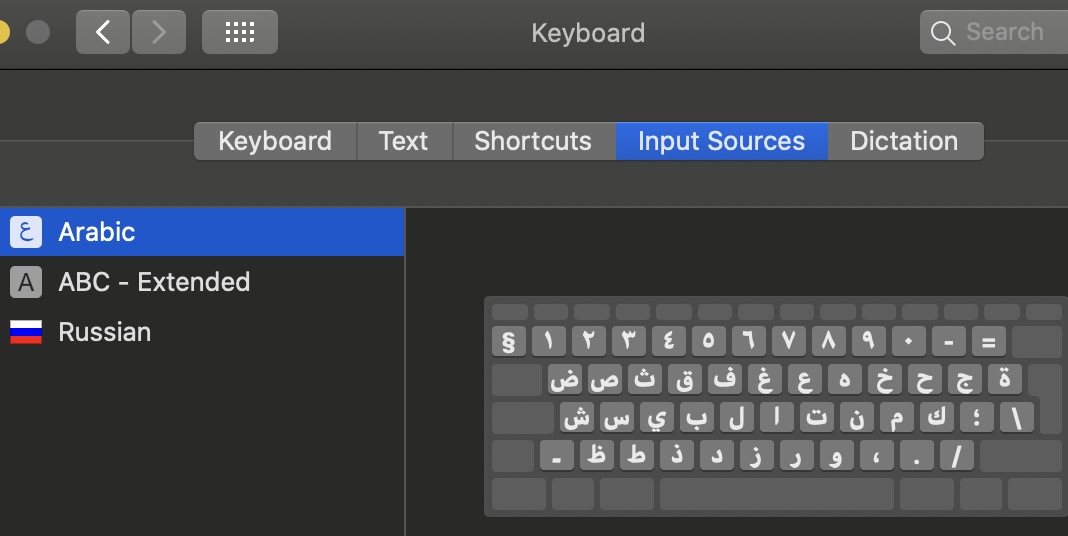

Keyboard Viewer will only show you the layout of the active keyboard.
To view Arabic keyboard layout, you have to make the Arabic keyboard active from the input source in the menubar. If Arabic does not appear in the inpt source, you have to add it from System Preferences>Keyboard>Input Sources:
Input Source.jpg (71.1 KiB) Viewed 16441 times

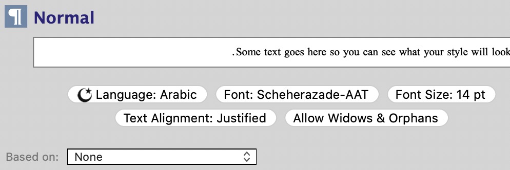

What you describe can only happen when a left-to-right script language paragraph style is applied to the selected text.
To overcome the problem, the paragraph style applied should have at least "Language: Arabic" attribute:
Ar para style.jpg (53.33 KiB) Viewed 16435 times
Re: Arabic -- Parentheses/brackets --- Quotation-marks/inverted commas --- Deletinig
Posted: 2020-04-03 07:16:29
by paieye
Thank you ! That is the answer. I have struggled with this for hours or even days. Arabic is quite difficult enough without getting one's word-processor in a muddle. I am truly grateful.
