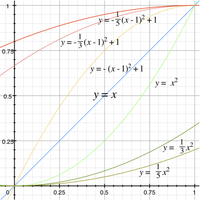

- New saturation is determined in the following manner:
 • if user input = 0, it is set to $fixedSaturationValue (you can customize it);
 • if user input > 0, it is set to -1/n * (x - 1)² + 1 (n: user input; x: original saturation);
 • if user input < 0, it is set to 1/n * x² (n: user input; x: original saturation).
In other words, with a positive number, 1, 1.5, 3... given as user input, the macro increases the saturation, with a negative number, -1, -1.5, -3... given as user input, the macro decreases the saturation and if your input is 0, the value of $fixedSaturationValue will be applied unconditionally.
As I'm not familiar with colours, I don't know if the formulas used to calculate a new saturation are appropriate. I think you can modify the routines for the calculations easily as far as Nisus Writer Macro enables you to do although the current command set of math functions is very poor.
