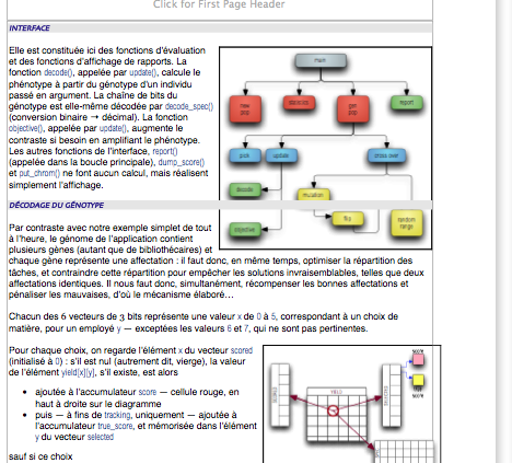

I'm having issues when migrating from Nisus Writer 1 to 2, as shown by the pictures I attached…
The first one has no workaround that I can think of: there's simply no way to do with NW 2 what could be done with NW 1; as shown by the pictures, the paragraph titles had a background color in NW 1, which I implemented in NW 2 with the paragraph shading feature — with the visible result that the shading doesn't honor the floating image area.
The second one is because graphics aren't exactly at the same place, and this can change the layout a lot: this is page 87 when the document is opened with NW 1.4.1, but page 89 when opened with NW 2.0 (0400.0004.02); please notice the second diagram on the page is slightly offset to the right by NW 2.0, and this, in turn, changes the text layout… and it changes it so much that the very same document will need 4 more pages than when printed with NW 1.4.1.

feat wrote:The first one has no workaround that I can think of: there's simply no way to do with NW 2 what could be done with NW 1; as shown by the pictures, the paragraph titles had a background color in NW 1, which I implemented in NW 2 with the paragraph shading feature — with the visible result that the shading doesn't honor the floating image area.
This is a bug; the paragraph shading shouldn't draw on top of the floating image, or perhaps extend into that area at all. I've filed it as something we need to resolve.
Would you be able to send me a sample document where a floating image's position on the page is different in NWP 1.4.1 vs 2.0? I can take a look and see what the problem might be. Hopefully it's just a minor file interpretation error that we can quickly correct. Oh, it's important that the file has not yet been saved by version 2.0, ie: it should have been produced solely in 1.4.1.

a 100 days later: as shown by the image below (captured while running NWP 2.0.2), this bug hasn't been squashed yet… and the paragraph-shading attribute color still prints on top of the floating image
and, oh, yes: when asked for a sample document long ago, this is precisely the one that I've sent to Nisus
I haven't had any news since then!
P-shading on top of F-image.png (87.66 KiB) Viewed 20240 times
also: I'm sorry that the new shape attributes don't have the default value that would make them totally inconspicuous when migrating from NWP 1 to NWP 2, because it means that now I'll have to manually set that shape stroke to none — and horizontal padding to zero — for hundreds of images whereas NWP 1 used to print them without any frames…

What bugs are you talking about? Yes, paragraph color and background color draw over the floating graphic, but only if you set the graphic to "Draw behind text". That seems to be the default, so that is perhaps unfortunate.
I also just tried the new nisus document with selection service on the page you described and it worked fine for me, as far as I can tell.
Re: paragraph shading overlaps floating images
Posted: 2014-04-08 14:28:08
phspaelti wrote:Yes, paragraph color and background color draw over the floating graphic, but only if you set the graphic to "Draw behind text". That seems to be the default, so that is perhaps unfortunate.
As Philip says, paragraph shading no longer always draws over floating shapes. Release notes indicate this was fixed for Pro 2.0.5.
The default for the "draw behind text" option is whatever was last used. NWP remembers and applies that to any new shapes you create.
