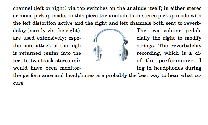

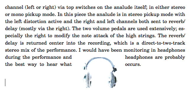

I'm regularly encountering a bug in PDFs made from Nisus Pro in which the image jumps a few lines (changes position relative to the text) in the PDF file.
See two images attached for an example of what happens: my original in Nisus is the one that only intersects two lines of text; the other one is what happened in the PDF; it jumped up several lines.
This time I needed to solve it, and on experimenting I discovered that it only happens if the image is 'Position relative to paragraph'. If I change it to 'position relative to page', it stays correctly in position.
This is only a hack workaround, because I need to change the images in the Nisus file back to 'relative to paragraph' after saving to PDF so they'll stay in the flow of the document when I'm editing.

Yes, this is indeed a known issue that doesn't have a general purpose workaround- sorry about that. But we are aware of this bug and want to get it fixed. Some things can help stabilize the image location, like changing the placement to "fixed on page" as Steven did. But clearly that isn't a viable long-term solution.
