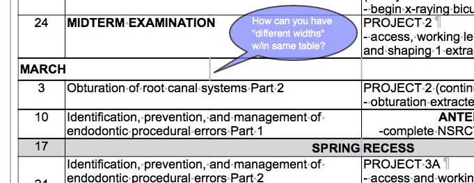

I have a document that I converted from MS Word to Nisus. A couple of the tables in the original document had tables where a few cells had different widths within the same table. I need to change some of the widths of individual cells but every time I try--as you've guessed--ALL of the cells change, throwing everything off. I have searched the documentation but haven't found an answer. I see that you can have a different number of cells within each row (page 205). As they say, a picture is worth a thousands words and I think it would be best here. I hope my feeble description and picture will be enough for someone to figure out what I'm trying to accomplish.
Thanks!!

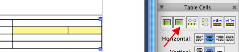

In the Tables pallette section, under 'Table Cells', the first two buttons in the top row allow you to split or merge selected cells. You could set the entire column with two cells as they will be in the row where you want them, then select the two cells in each applicable row and merge them. If you split cells you can resize them but it seems to effect the entire table as well so you would need to experiment a bit.

As rfwilmut says the table you are showing actually has 4 columns (in the visible part). In most rows, columns 2 & 3 have been merged, but in the "March" row the columns 1 & 2 have been merged.
