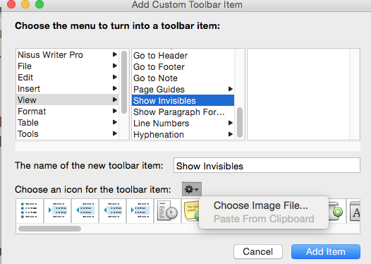

I can't figure out what steps you are following to get that result. Here is how to proceed:
To add a custom toolbar item to the Toolbar, Right-click the Toolbar and apply the menu 'Add Custom Toolbar Item...'.
You will be presented with the Add Custom Toolbar Item pane:
Select the menu command you want to place in the toolbar, for example, View:Show Invisibles. Then choose an icon for the toolbar item from the icons shown. If you don't like any of them and prefer to make your own icon, apply the 'Choose Image File...' from the gear menu. You can then navigate to an image file of your own choice from any images freely available.
The image that you choose will not be modified or moved; it will simply be used to create its iconised form which will be added to your own toolbar icon library and the Toolbar.
