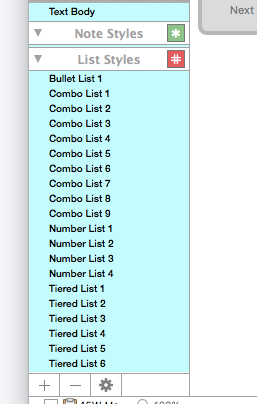

I'm pretty sure that this is what he is talking about:

Þorvarður wrote: 2018-06-27 01:55:51 I run the macro early this morning on a document with several different list styles, but nothing happened. Now, several hours later, I tried again and now I get the error message that there is an error on line 18: the variable "$type" has not been defined.
I see. I'm guessing that you have list styles that have a name that does not contain the word "List". I realize now that I should probably handle cases like that better. Thanks for the feedback.
But it's also true that if you don't have groups of styles of the form "Numbered List 1", "Numbered List 2", "Numbered List 3", … you will not see any effect from my macro, even if it completes successfully.
