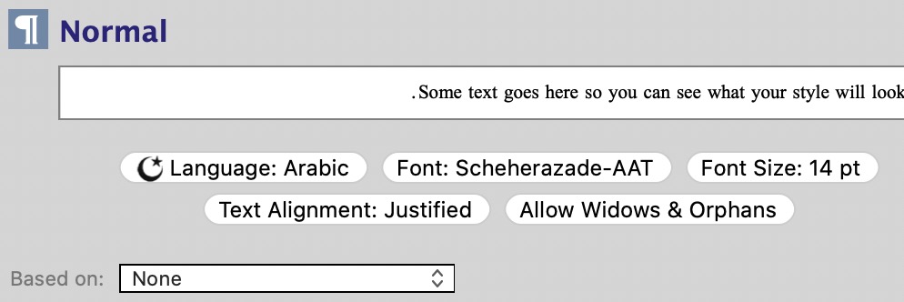

Re: Arabic -- Parentheses/brackets --- Quotation-marks/inverted commas --- Deletinig
What you describe can only happen when a left-to-right script language paragraph style is applied to the selected text.
To overcome the problem, the paragraph style applied should have at least "Language: Arabic" attribute:
Ar para style.jpg (53.33 KiB) Viewed 16285 times
paieye
Posts: 53
Joined: 2020-02-07 10:57:10
Post by paieye »
Thank you ! That is the answer. I have struggled with this for hours or even days. Arabic is quite difficult enough without getting one's word-processor in a muddle. I am truly grateful.
