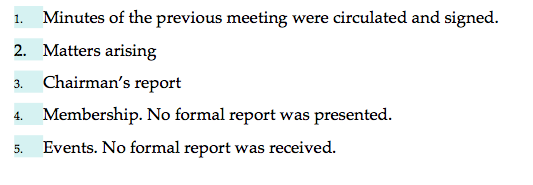

In the attached document, I have several numbered list items in my paragraph styles and I want to edit the one named "List 1 #".
As you can see, the number is several point sizes smaller than the text in the list and I want to make the # more readable.
NWP revise # size query png.png (25.97 KiB) Viewed 5659 times
I have tried selecting and increasing the font size of the second number, but Redefining from Selection does NOT increase the size of the number for all of them.
How do I increase the font size of the number while leaving all the item text in the list unchanged?

When I check your LS1 list style in the style sheet it seems to have a 7pt Palatino specified. That is what enforces the smaller style for the list numbers. If you want the list style to take on the attributes of the style LIst 1 # you should remove that specification.

Editing the size of List Style LS1 numbers does indeed solve the problem.
