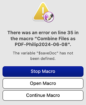

The macro required that I select a folder, so I selected the folder where all the files are. But then it gave me this error:
I think the macro failed to ask me where to save the file or the file name. I guess it would be good if it would let me choose a file name.

Re: Macro to combine multiple files into one
If it gives you this error, I must assume that the files are named in a way different from what I took to be your description.
The macro here assumes that your files have names like this:
01.01myfile.rtf
01.02myfile.rtf
02.01myotherfile.rtf
… and so on.
Maybe you should give a more concrete example of how the files are named?
