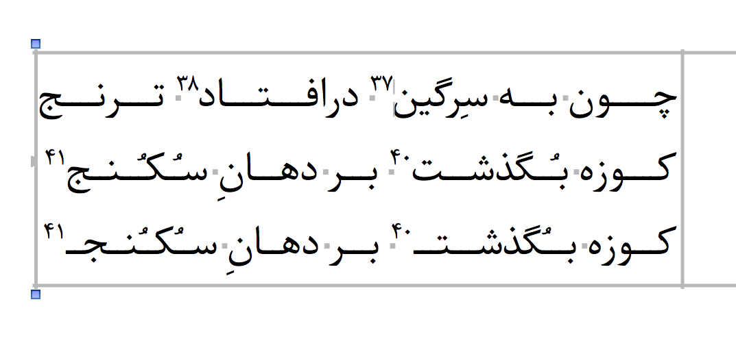

I have found another place where footnotes cannot be inserted: text boxes. Due to the way I want to format the poetry I previously described, I want the poetry to be justified but any footnote reference to appear beyond that. I thought 'text box', but I can't add a footnote reference there either.
In addition I have found that the kashida formatting is a bit broken and if I use it I have to spend a lot of time tidying it up afterwards:
1. If I add diacritics to show the non-written vowel or correct pronunciation and then chose to format using kashidas, the diacritic is pushed neared to the letter following rather than remaining near the first letter.
2. Sometimes the font 'breaks', even though there is not a problem with the font per se. The end of the letter breaks.
In the file I have attached, the first line shows a correctly formatted line of poetry. This is the simplest type of line. It has no diacritics and there are no footnote references (or not-real footnote references) at the end of the line.
The second line shows a line AFTER I have tidied up the troublesome diacritics. However the full justification includes the footnote reference so the poetry itself is not flush.
The third line is a copy of the second line but without any tidying up (i.e. after applying the kashidas). It is clear that the diacritics are pushed to the following letter, and that the 'te' and 'jim' letters are now broken.
I am finding that using Nisus Pro is problematic rather than a pleasure. I am having to workaround lack of footnotes in tables, broken kashidas and justification problems.
Maybe what I am looking for does not exist. But certainly some features do exist elsewhere (e.g. OpenOffice allows footnotes in tables). Something that Nisus Pro does well, that I can't find elsewhere, is multiiple footnotes on one line.

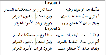

Re: Footnotes from within tables?
In NWP it is possible to arrange lines of poetry with note references by using tabs and kerning.phspaelti wrote:[...]And now going out more on a limb here, because I don't use Arabic. Is it not possible to arrange the poetry using tabs? Obviously the macro seems to be written for paragraph wide justification, but perhaps that problem can be solved. If you used tabs, footnotes would become a non-issue. But obviously Arabists will have to tell me if that is not possible.
In NW Classic this was achieved by using Forced Justify Tab which justified symmetrically two hemistichs of Arabic/Persian poetry on a single line, taking care of any kerning.
Here is an example to show how kerning, both Tighten and Loosen as appropriate, can be used to workaround this layout problem.
In the examples, Layout 1 entered without kerning, and Layout 2 with kerning applied:
download/file.php?id=85
