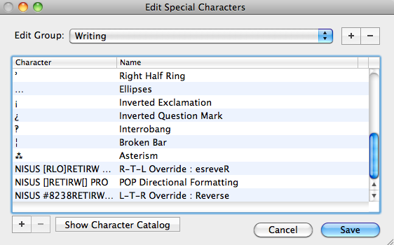

Now, it's more complicated for me. Can you tell me what did you type in the first box, and the second box? When I say box I mean that there are two boxes in the Edit Special Characters, after I press on + there pops a box with ?? in it (two question marks), and they're highlighted. So, what do I type in there, and then when I press tab, I am taken to the next box, and what do I type in there? I am assuming I need to have three rows, right?
I tried to copy your screen shots. I am attaching the screen shot.
Any way, I tested and this time the selected word was replaced by the words in the first box…!

Unicode is strictly plain text - for tricks as esreveR you place invisible code points within the text to get the text engine do the job. My screen shot has seemingly EMPTY "boxes" in the first column, but there I entered the invisible code points, so no wonder. In the "boxes" of the second column you are free to enter whatever - and there's no third column…
In the case of "Nisus retirW Pro" you just enter: "invisibleRLO"Writer"invisiblePDF" and you are done - try it with Character Viewer first…
Good luck
HE

I am sorry for not able to get it, yet. I have asked a friend of mine who is Genius at Apple Store (here in Glendale, California) and we tried to follow your screen shots and your guidance, and we were at loss! I am attaching a screen shot of the page and would like to ask you what would you type in the box that has double question mark (??)
When we looked at your screen shots, we saw a line that we couldn't figure out how did you manage to have it show like that: In the Writing submenu you have Reverse : O-L-R and this line is crossing from the first to the second boxes!!!
So, if you may, could you tell me what to type in the box that has double question mark (??) Here is the screen shot.
Thanks HE

Hi Windsor -
your screenshot is TOO small in size - but I guess the trouble is with entering "invisible code points" in the first/left column. I did it from "PopChar" - but "Character Viewer" will do as well. Problem is, you have to click in the field of the "Nisus Menu to enter" first and to double-click the invisible character in "Character Viewer" next - with NO click in time between, because the double-click in "Character Viewer" will enter the "invisible character" in the cursor place clicked JUST before. Second problem is you won't see any character entered in the first column of the Nisus Menu - because the character entered is an "invisible code point". That's just about all I can help you with - Ulrich, who is used to tricks like this, did succeed in first try. But I understand that to be too tricky for others maybe - so Martin should maybe help with integrating "Format characters" like this into the "NWP Insert Menu"…
You can try to do without customizing the NWP Insert Menu - just enter "RLO" & "PDF" from "Character Viewer" as tagging characters for esreveR style on the fly…
