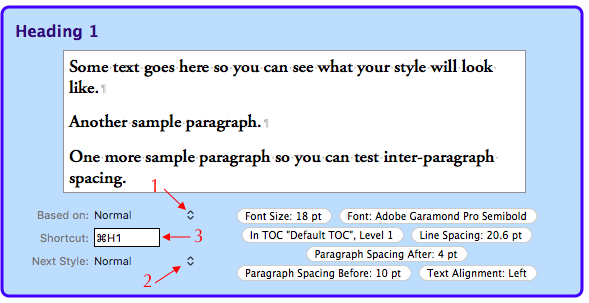

You can absolutely do this already:
1) set up your heading styles, based on a list style with appropriate numbering;
2) set it to be followed by your "Normal?Body/whatever" style that you want to follow headings;
3) set the shortcut you want to use in the box in the dialog—one of the really great things about NWP is you can use multi-key shortcuts, so my "Heading 1" style has the shortcut 'Cmd-h,1' making it easy to remember.
See attached image: NB, I don't include numbering in my headings by default, because generally I'm importing from Scrivener which sets the numbering during Compile.
Now every time you want a new chapter, you just use your shortcut combination and when you've entered the chapter title text you hit return and you are taken straight into the style you have set for your first paragraph.
Screenshot 2016-11-06 12.39.27.png (39.51 KiB) Viewed 12275 times

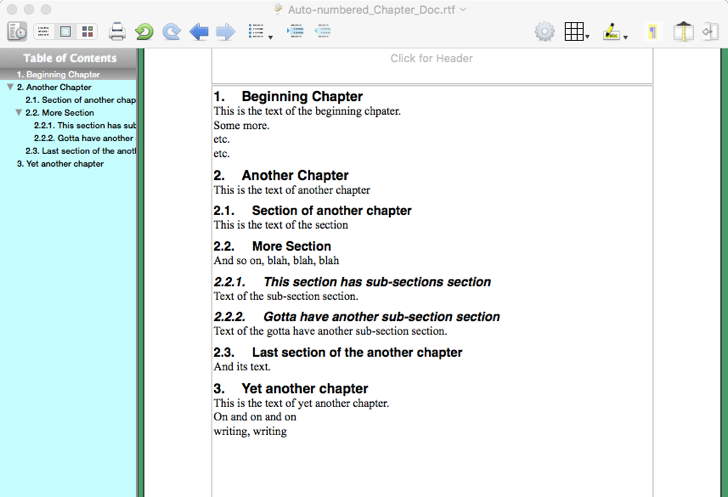

Basically as Mark explains, but just to be clear, I would recommend attaching your chapter numbering style to the Heading styles. That way the numbering is inserted automatically. I think Mark is saying that, but his pix doesn't show it.
(I also note that Martin's earlier sample doc didn't do that.)
Here is my sample doc, as an image:
In writing the above, I work as follows:
  1. I use the short-cut <cmd>1 to get Heading 1 style ==> The number 1. is inserted.
  2. I type the text of the heading and press <return>
  3. Now in Normal style I type the text of the chapter
  4. I use the short-cut for the next chapter or section heading ==> the appropriate number is inserted.
  5. I type the text of the heading and press <return>
  6. And so on…
Notice that the headers also appear in the Navigator TOC.
And here is the sample file:
Auto-numbered_Chapter_Doc.rtf
(20.61 KiB) Downloaded 753 times

Yes, I am saying to attach a numbering style to the chapter headings; it's just that for the reason I gave, I don't want NWP to do the numbering.
The easiest way to set up such a chapter style is:
1) make a new paragraph;
2) set the font, variant—bold, etc.—and size using the Character palette;
3) set the justification, space before, space after and 'Keep with Next'—so that you don't get a heading orphaned at the bottom of a page—using the Paragraph palette;
4) set the numbering type you want from the Lists palette;
5) on the Styles palette, click the + sign at the bottom and choose 'Paragraph Style based on Selection', that will take you to the screenshot in my last post where you give it a name, set the next paragraph style and your shortcut;
6) click on 'Save to Style Library…' and save it appropriately so that you can import it into any new or existing documents; even your "Nisus New File" can be edited to include it automatically in all new documents.
