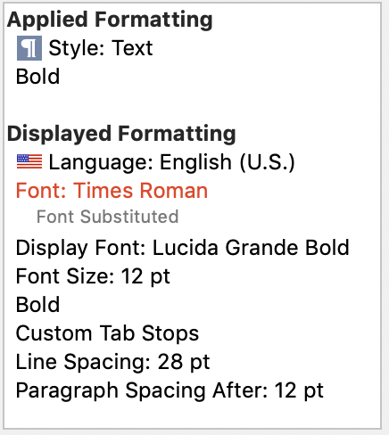

And this is what the Formatting Examiner tells me:
Screen Shot 2019-02-15 at 14.16.03.png (94.96 KiB) Viewed 4739 times
If I could make this recur reliably, I would let you know how, but right now it is a big mystery.
