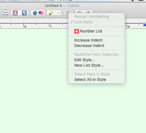

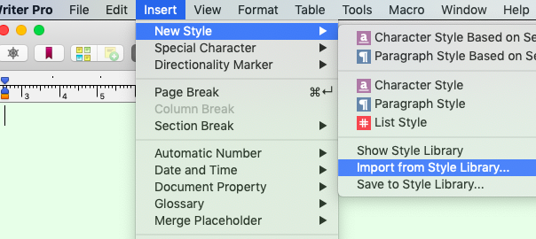

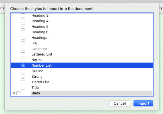

I'm not sure what's happening here. But let me say first, that in your screenshot you seem to be trying to import a list style. List styles will show up in list style menus, not with the character styles, just to be clear. So here my screenshots of the process:
Import style menu:
Screen Shot 2020-04-20 at 20.51.58 .png (205.45 KiB) Viewed 23555 times
Choosing the (List) style:
Screen Shot 2020-04-21 at 14.26.19 .png (83.33 KiB) Viewed 23555 times
