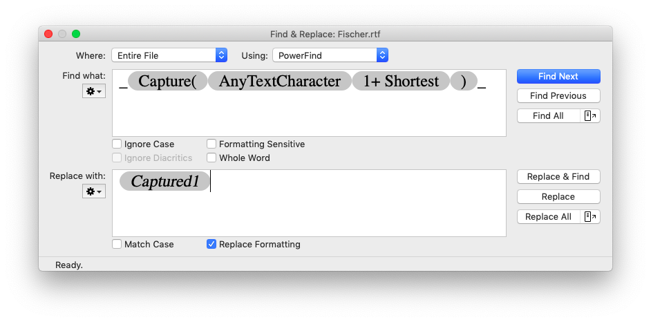

Actually for this kind of thing you don't even need a macro. You can use Find/Replace:
Note that the replace expression has the Italics applied.
You can of course macroize the above, but you'll need to be careful about the interactions with styles in the macro. So I prefer doing it in two steps: (1) Find/Replace (2) apply the Italics. To be fail safe you should test before applying the italics.
if Find and Replace '_(.+?)_', '\1', 'Ea'

Good Grief! The Find/Replace routine works! I had no idea it was possible. :)
I'll have to study the Find/Replace documentation... It's not at all obvious why you wouldn't use "AnyText" as the wildcard. [...and at the moment I have no idea what "1+shortest" is/does. Time for some reading.]

Consider the following case:
_Nisus_ Writer is a great _document_ processor.
If you ask: "What is the text between two underlines?", you might answer "Nisus" and "document". But there is another possible answer: "Nisus_ Writer is a great _document".
An algorithm that prefers the second answer is called "greedy". Powerfind is greedy. Using "shortest" is the way to get Powerfind to stop being greedy.
