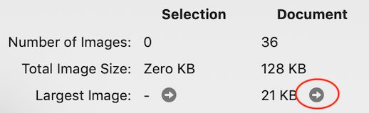

Here's another tip that can help you identify which images are using the old PICT format:
1. Open your document.
2. Use the menu File > Image Analysis
3. In the dialog that appears, click the arrow icon under the Document column:

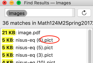

You'll see a list of all images in your document. You can identify PICT images by their .pict file extension:
You can click entries in the list to see them selected in your document.
