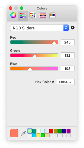

You would need to copy the above two line macro for each background color you wanted. You can customize it by changing the hextriplet. You can find the hextriplet for any color you want using the color panel. Just switch to the RGB sliders.
Screen Shot 2020-06-30 at 1.24.35 .png (56.02 KiB) Viewed 11393 times
Below the sliders you can see the Hex Color # for the selected color.
The Nisus macro language allows you to specify the color using the RGB system as well, either as fractions (0.0 – 1.0) or as 0-255 values, but the hextriplet method is the shortest.
To set a shortcut for your color, you will first need to save the macro giving it a name, and then set the shortcut using "Menu Keys" preferences.
