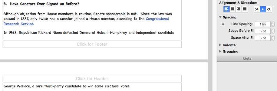

For a multi-page file, an undesirable gap is sometimes left at the bottom of the page, even though there is room for one or more extra lines of text. Apparently, if NWE is unable to fit an entire paragraph in the remaining space, it treats it like an image and puts it on the next page. The first snapshot below is an example.

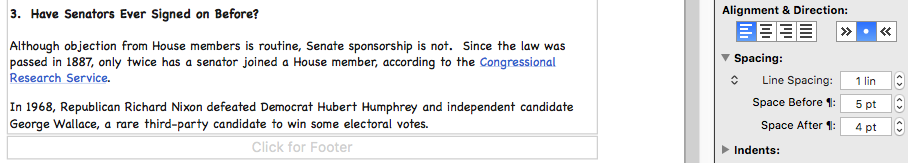

If a tiny bit more space is made available on an earlier line by decreasing the ‘Space After’ from 5 to 4, the whole two line paragraph is accommodated:

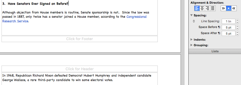

If the two-line paragraph is split by a hard return at the end of the first line, it is fitted into the original gap.

What you're seeing here is an often desirable feature called widow and orphan control. Nisus Writer automatically works to prevent single lines of text from appearing by themselves at the start/end of a page.
If you don't like the feature you should disable the option. You will see it listed on the menu under Format > Paragraph > Prevent Windows & Orphans, or in the Paragraph palette under "Grouping".
This feature is applied per paragraph; a single document can include paragraphs that both prevent and allow these lines. However, if you don't like the feature, you probably want to disable the option for your entire document by editing your style sheet. Usually that means you will want to adjust your document's Normal paragraph style so it allows widows and orphans. Taking that a step further, you may want to disable the option for all new documents you create by editing your new file template.
