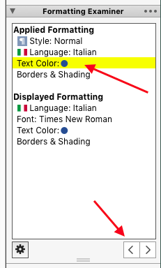

Have you tried the Formatting Examiner palette? The FE is one of the most useful and flexible additions in NWP3.
You just have to select the attribute (blue text color in your case) and use the arrows.
Screen Shot 2021-01-09 at 01.30.10.png (25.69 KiB) Viewed 37435 times

@johseb, @phspaelti
Thank you both.
The Formatting Examiner is exactly what I need, and I'm delighted that I can use it for other things also.
And I've tested the 'Wild Card' method in the Find Dialog box, and it does the same.
And I've even discovered that there's a popup at the bottom of the page, when the text is coloured, that gives the same option.
Great. Now I have three ways to do it and don't have to bother with making styles! :D
