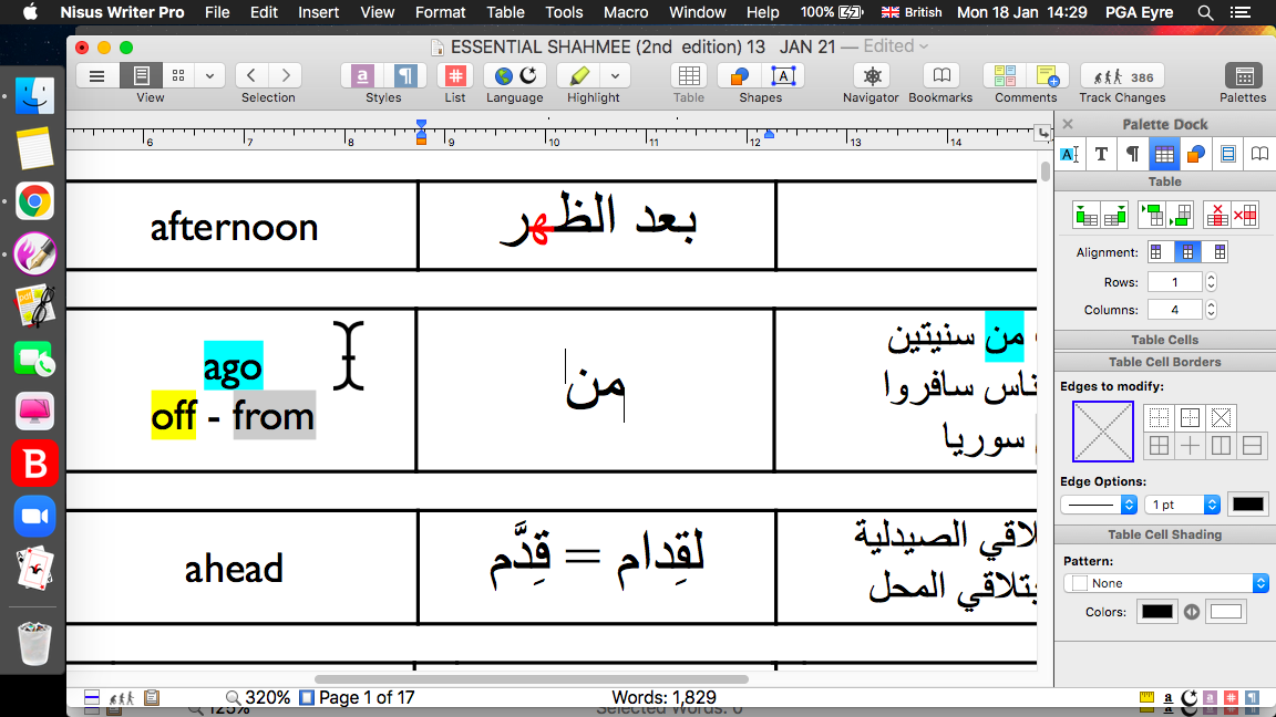

First of all, my apology if I have asked this or a similar question previously.I seem unable th for the time being to find my previous posts in this forum. I have constructed a table using NWP to listArabic words and their English translation.I send the document, formatted in RTF, to my correspondent. Using MS Word, shd makes corrections and adds comments, and then returns the result to me, again formatted in RTF. I attach an example. As you can see, my table has come back to me with the rows separated from each other by a blank line. Can this be put right ?
Screen Shot 2021-01-18 at 14.29.02.png (215.17 KiB) Viewed 13732 times

Probably the best way to identify the problem is for us to see the problematic document. Could you please send me a copy of the file you received from your correspondent? It's important that you send the file as saved by Microsoft Word, before it's reopened and resaved by Nisus Writer.
It's best if you send us the file using the menu Help > Send Feedback, but you also email it to me at the following address. Thanks for your help!

Thank you for sending your file paieye! I've taken a look and the quick evaluation seems to be that this is a bug in Nisus Writer. The table in the RTF file is being loaded incorrectly. We'll have to investigate further to know more. I'm sorry for the trouble.

This issue has been resolved in Nisus Writer Pro version 3.2.2. That software update is available everywhere: inside the app, the Mac App Store, and direct download.
