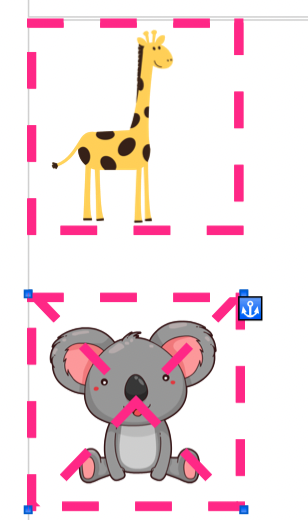

When I tried to following very simple code:
$doc = Document.active
$fcs = $doc.allFloatingContents
$lineAttributes = $fcs[0].strokeAttributes
$fcs[1].strokeAttributes = $lineAttributes
This is the result I got:
Before
Screen Shot 2022-03-01 at 0.41.51.png (107.97 KiB) Viewed 6632 times
After
Screen Shot 2022-03-01 at 0.42.09.png (112.15 KiB) Viewed 6632 times
There doesn't seem to be any way to control which edges of the floating content to apply the attributes to.
