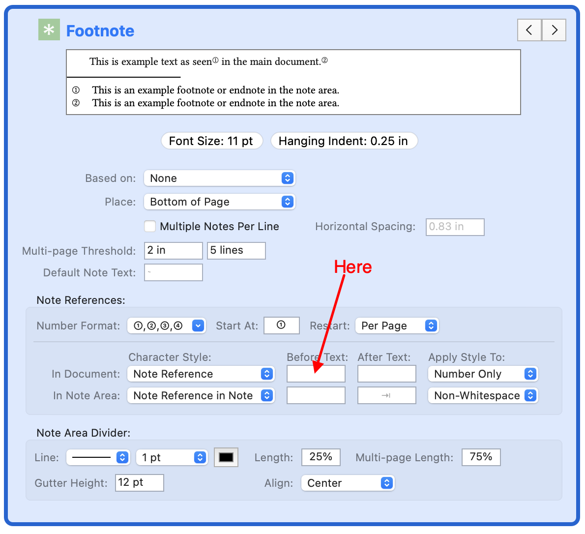

Does anyone know how to insert the 'Narrow No Break Space', Unicode U+202F/UTF-8 E2 80 AF, into the 'Before Text' space in the Footnote pane of the stylesheet in such a way that it will be saved.
Screenshot 2022-07-09 at 15.16.08.png (121.17 KiB) Viewed 11897 times
I wish to use it in at least one of my style collections that I apply to an existing document via a macro. If I insert it directly into the document's stylesheet it seems to apply, but when I try to insert it by editing the style collection, it doesn't seem to survive the saving of the style collection.

24 views but no suggestions. On the other hand I have solved the problem.
As I found, modifying the style in an actual, content-containing document seemed to preserve the space on saving, closing and reopening, where modifying the style collection—an RTF document with no content but with a stylesheet—did not preserve the space.
So I started from a document with a footnote, ran the macro to apply the relevant style collection, then modified its stylesheet to include the "Narrow No Break Space". Having checked that the space survived the save-close-reopen routine, I went to the stylesheet, selected Footnote and selected "Save to Style Library" and chose the relevant collection.
I then took a different document with a footnote, ran my macro, and the space was there before the footnote marker.
I'll leave it to Martin—if he thinks it's worth his while—to work out why I failed to add it directly into the style collection document when adjusting other aspects of styles works without problems. :D

I created a Footnote style using a narrow non-breaking space and saved it to my Style Library. I then imported that saved style into another document and replaced the existing footnote style. Everything worked as expected: the imported style enforces the narrow non-breaking space.
A few points:
1. You mentioned macros. I didn't follow that too closely, but if you do whatever you're trying to accomplish without any macros, does that make a difference?
2. When you saved the Footnote style to your Style Library, did the destination style collection already have a Footnote style? I'm seeing some weird behaviors in situations where a style collection already has a footnote style. This is almost certainly due to the constraint that each file (and thus style collection) can only have a single footnote style. In this situation it looks like saving a footnote style to the style library may fail to replace the existing style.

My problem was when editing my style collection directly — e.g. ~/iCloud Drive/Nisus Documents/Style Library/Standard.rtf — by opening it in NWP. When I modified the Footnote style in another (normal) document and exported it to the style collection to replace the existing Footnote style, it worked perfectly as I said in my second post. I tested the resulting style collection on both the iMac and the M1 MBA. It was editing the style collection itself that didn't seem to work for this, even though doing other things like changing the "Normal" font was not a problem.
