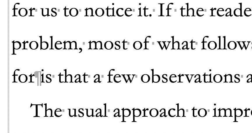

Re: Unselectable paragraph marker in the middle of text
Here is a screenshot. The offending paragraph sign is on the third line after "for".
Thanks for the screenshot. I haven’t seen this before.Purpendicular wrote: ↑2024-07-09 11:25:58 The offending paragraph sign is on the third line after "for".
We may get pesky gremlins if we copy and paste from a PDF or a browser, or import stuff directly from other applications. The good thing is, however, in the past I have always been able to quickly get rid of such gremlins.
In your particular case,
1) Place the insertion point directly after the “r” (of the word ‘for’), press and hold down the Shift key and then press the right arrow key. This should select the gremlin, but you won’t see any selection on the screen!
Now execute the menu command “Copy to Find” from the Edit menu in order to get this alien character as search term into the Find & Replace box. Open the Find & Replace box. If we are lucky, it’s now already in the Find box, although we may not be able to see it. With the Replace box empty, click on ‘Replace All’ to remove all instances from the document.
2) If that doesn’t work, then simply copy and paste the whole document into a new empty Nisus document. Gremlins will not survive that action!
I take it for granted that you have already run the macro “Zap Gremlins” which Mark suggested 8 days ago. You should definitely let him know. He deserves a feedback from you.
If the problem persists, then please upload a part of your Nisus document where this alien character appears. I want to get to the bottom of this. :–)
Thanks for the suggestions. Zap gremlins did not find anything.
When I pasted into a new document, the characters disappeared. Unfortunately, even though I used "Use pasted styles", my footnotes came out as British English, Times New Roman 12 pt, normal line spacing, instead of US English, Garamond 11 pt, 1.5 line spacing.
