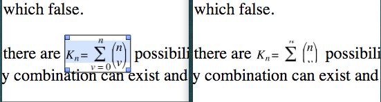

Re: Fixed line spacing is hiding in-line equations.
Posted: 2009-04-10 03:31:55
by Kino
Some weeks ago I encountered this problem and asked them to improve the situation in a feedback on another problem affecting the same document.
At that time, I did not see the situation well but now I think it should be possible to change NW Pro's treatment of inline images so that they are totally visible because they are so in the selected state.
As you see, text above or below would not be hidden by the image because the background of the image (generated by Grapher.app) is transparent.
