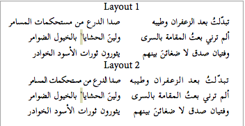

Here is an example to show how kerning, both Tighten and Loosen as appropriate, can be used to workaround this layout problem.
The following screenshot shows Layout 1 entered without kerning, and Layout 2 with kerning applied:
- kerning.png (26.08 KiB) Viewed 54112 times

Thanks, Hamid.
Use of kerning is nice, but manual. In the similar vein, one could insert the Kashida manually as well - and that is what I currently do .
