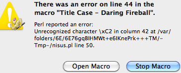

However, when I run the macro, NWP produces the following error msg:
Screen shot 2011-09-30 at 3.52.54 PM.png (35.26 KiB) Viewed 54877 times
When I click Open Macro in the error msg, the following line of the macro is highlighted:
\b (_*) (?:
Re: Title Case
Ah yes. That character \xC2 is a non-breaking space, introduced by the forum when you copy-paste code from the web. Perl doesn't like it. You can fix it by replacing all non-breaking spaces in the macro with regular spaces. Or download the macro I'll attach here.
