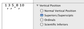

Thanks for your kind words on Nisus Writer. I'm sorry you've had trouble with the superscripts. I think I understand your problem, but to make sure, consider the following screenshot:
Is the problem that sometimes the super/sub-scripted numbers look like line one, and other times that they look like line 2? If so, I can explain the issue. In that first line proper typographic superscripts are used (ie: NWP displays special superscripted glyphs provided by your font), in the second line NWP is showing faux superscripts (accomplished by shrinking the font size and raising the baseline). Proper typographic superscripts will always look nicer and provide more clarity (and in this case are noticeably larger), because they were specially designed by the creator of the font.
Can you spot what characters are missing from the top line? The commas and dashes. When those characters are encountered they prevent the display of proper typographic superscripts because your font (Cambria) does not have glyphs for them. You can verify this in TextEdit, which does not provide faux superscripts:
When NWP encounters this situation (ie: a sequence of mixed characters, some which support proper typographic superscripts, and some which do not), NWP chooses to use faux superscripts. That's because the baselines for faux and typographic superscripts can be quite different and appear "ragged". That said, perhaps we can improve on the situation, either by special casing commas, periods, and dashes, or perhaps by allowing the mixed superscripts if the glyphs appear similar enough. We'll have to file it and investigate possible satisfactory solutions.

Wonderful! I think the typographic vs. faux superscripts perfectly explains why my citations look funny. Is there a font I could switch the document to that has a full set of superscript characters, say Times New Roman, that would eliminate this behavior?
It also occurs to me that the sub- and super-scripts I am having the most size-changing problems with are symbols such as "+" and "-", which would also be faux superscripts.

Vivagen wrote:Is there a font I could switch the document to that has a full set of superscript characters, say Times New Roman, that would eliminate this behavior?
Yes and no. I was able to find a few fonts that include typographic superscripts for "." and "-" (eg: Garamond Pro, Arno Pro, Minion Pro, etc) but none that include the "+" symbol. Sorry about that.

If you use the Character Viewer, Superscript Plus Sign is unicode U+207A or or E2 81 BA in UTF-8 (check the "Related characters" area having selected +). On my system it is available at fully raised baseline in the fonts Charis SIL (A TNR-alike font with the phonetic symbols and extensions, free from SIL), Lucida Grande and Monaco and at slightly lower raised heights in a number of others including Menlo.
If you used one of those fonts you could set up a quick-fix substitution to access it easily.

Thanks for that Mark. I forgot about the special pre-superscripted Unicode characters (we should add them to the default special character menus). There's also U+207B for a pre-superscripted dash/minus, which Cambria also supports.
Though if she uses those characters, she'll have to avoid applying superscript formatting/attributes to them, since that would double up the superscripting and make the plus/dash too small. Perhaps if NWP encounters a pre-superscripted Unicode character, it should ignore the superscript attribute, I'm not sure.
