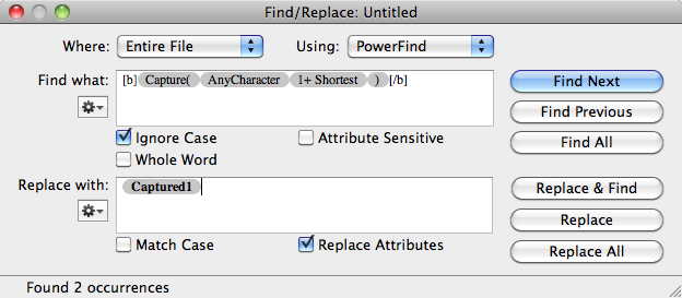

The find box should look like this:
If you do "Replace All" now on a file with that kind of mark up you should have your mark up turned into formatting.

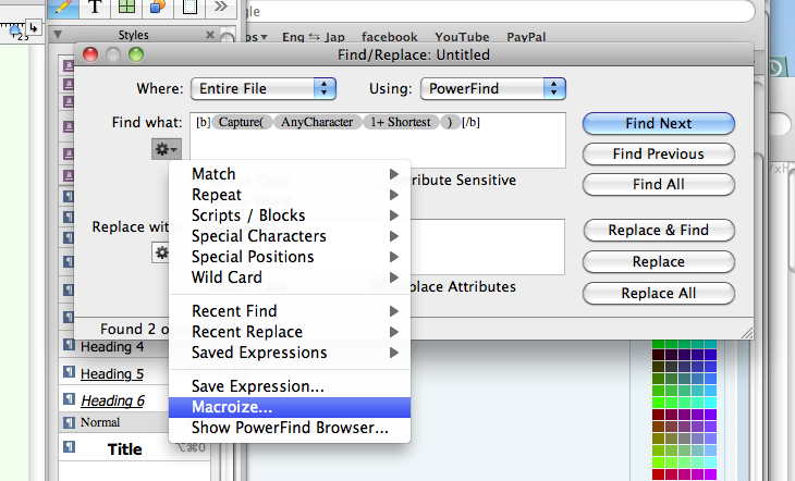

To get a macro, you do the following.
  1. From the gear menu choose "Macroize…"
    choosing "Macroize…"

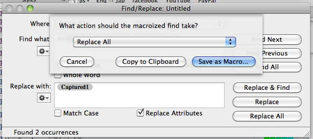

  2. In the macroize window specify "Replace All" and then do "Save as Macro"
    Save as "Replace all" macro
Repeat the whole thing for the other tags. :!: Make sure to apply the formatting you want -- and to clear out any formatting you don't want -- in the replace box. :!:
