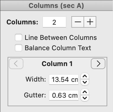

CrisB wrote: 2023-03-18 06:14:18 So how do I get the gap between the columns where I can put a line to be the same as the inner and outer margins on the page?
You should use the Columns palette for this purpose:
You can use the "gutter" property to set the spacing between columns, and checkmark "line between columns" to add a dividing line.
I've tried selecting part of the page as well as it all, but NWP > Table > Distribute Columns Evenly is greyed out. How can I get to use it?
That entire menu is only for Tables. That command does not affect section columns.

Posted: 2023-03-21 08:36:32
by CrisB
Thanks, that works and it now looks great.
