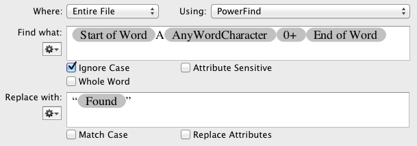

Could you provide an example that includes the (Found) bubble?
Re: PowerFind question
Posted: 2013-02-22 14:55:45
writerhoward wrote:Could you provide an example that includes the (Found) bubble?
Sure thing. As a contrived example let's add quotation marks around all words that start with the letter "A":
