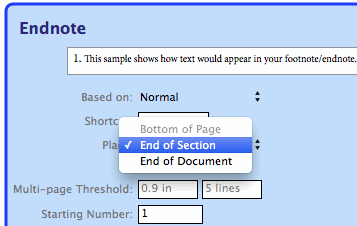

Windsor wrote:Is there a way I can put the bibliography (and anything else for that matter) AFTER the endnotes, so that the endnotes will be "part of" the subject, and at the "real" end have the index and the bibliography?
In the Style Sheet, for Endnotes apply 'End of Section' instead of 'End of Document'.
Then just before the Bibliography insert a section break.
Windsor wrote: Also: Is there a way to switch between footnotes and endnotes?
You can toggle between Footnotes and Endnotes by selecting all the notes and then from the green tag in the Statusbar applying Footnotes or Endnotes:
