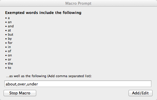

In the style guide I follow for academic papers, all prepositions within a title are not capitalized. So, if I did not want "about" to be capitalized, would I just add it to $defaultList in the Title Case Exempted Words macro in the correct alphabetical position and then save the file?
Howard

Posted: 2014-03-03 19:32:10
Howard,
no you don't need to change the default list. In fact if you have already run the macro once, changing the default list will do nothing.
But adjusting the list of words that you want to exempt is what the "Title Case Exempted Words" macro is for. Just run the macro and add (or remove) any words you want. The macro is going to store the list of words in a special user registry, so after you adjust the list, that list will continue to be active on your computer 'forever'. If you want to change the list, or check what's in the list, just run the macro again.
Here is what it will look like if you run the macro to add some prepositions to your list:
So run the macro, and add all the prepositions you need. If you later find that you have missed some, just run that macro again.
After you have set the list to your liking, the Title Case macro will capitalize all words in your title except for whatever is in your list.
Hope this a bit clearer now.
Philip
