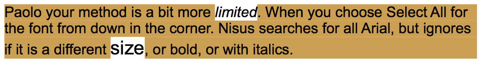

lindas2013 wrote: When you choose Select All for the font from down in the corner. Nisus searches for all Arial, but ignores if it is a different size, or bold, or with italics.
This must to be a misunderstanding. Choosing "Select All" will only select a font with the same character attributes.
The text in the following screenshot is in Arial. Place the cursor somewhere, not in italics or the different size though, and everything will be selected *except* italics and the different size. However, if you place the cursor where italics is, then only the same font in plain italics will be selected, not text in bold and italics. The same applies to different size.
