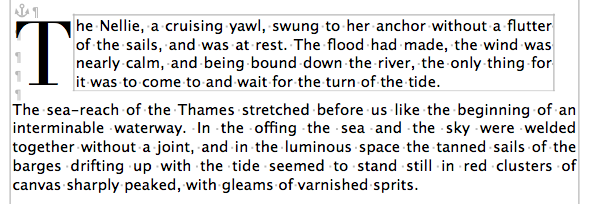

useeger wrote:I fear, the only way to accomplish that task is to insert the initials as graphics
Have you tried text boxes?
Screen Shot 2015-09-17 at 15.48.08.png (55.48 KiB) Viewed 47851 times

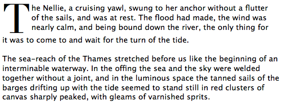

Re: Initials
Posted: 2015-09-17 06:20:37
by useeger
Oh, nice idea! Didn't try it. Seems to be a little bit tricky with the spacing of the lines (in your example line 4 has an additional space, what is not wanted).
I made it now by inserting graphics of the big letters. It worked fine and it wasn't as complicated as I feared.
Enclosed an example how it looks like now
Thanks for help
Ulrich

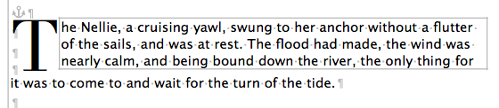

Re: Initials
Posted: 2015-09-17 07:37:16
by Þorvarður
You can use the Shape Metrics palette to tweak the size and determine where the shapes appear on the page.
Shape Metrics palette.png (26.21 KiB) Viewed 47836 times
I think line 4 has now the same space:

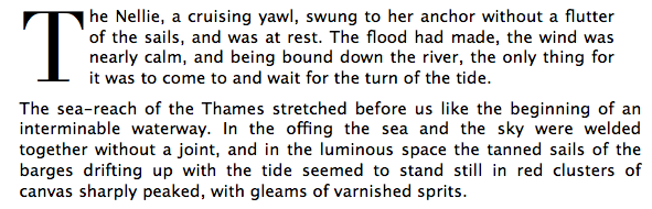

Re: Initials
Posted: 2015-09-17 11:14:32
by useeger
Very nice, never saw before "shape metrics". One never stops learning.
But now line 5 should also have the same space, then it is perfect.

Re: Initials
Posted: 2015-09-17 13:47:45
by useeger
I think, there does not exist a printed edition of Joseph Conrad with additional space before paragraphs. In print a new paragraph is marked by indentation, not by additional space.
I prefer 3 lines for the height of the initials, but that's not important, others may make 4,5,6 ... lines. Enclosed an example how it should look like, I hope it's clearer now. I am sorry for my lack of clarity.
If the first paragraph of a chapter is very short (in my case less than 4 lines), these initials make some additional problems. Therefore I avoided the paragraphs which are in the original text in my example .
