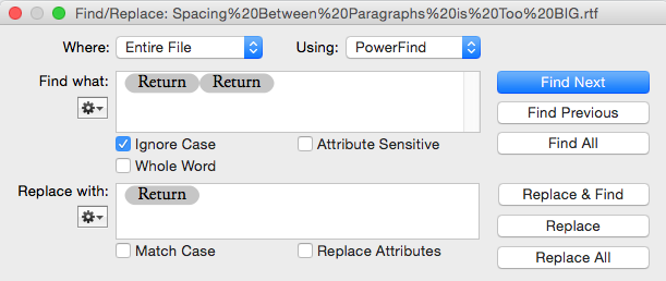

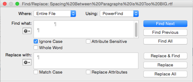

tommyzai wrote:Uh oh! I just used the find and replace to remove all blank lines and made a mess.
It looks like you accidentally replaced all newlines with nothing. You want to replace all double returns with *single* returns. You'll want your Find & Replace dialog to look like this:
Or if you're using PowerFind:
