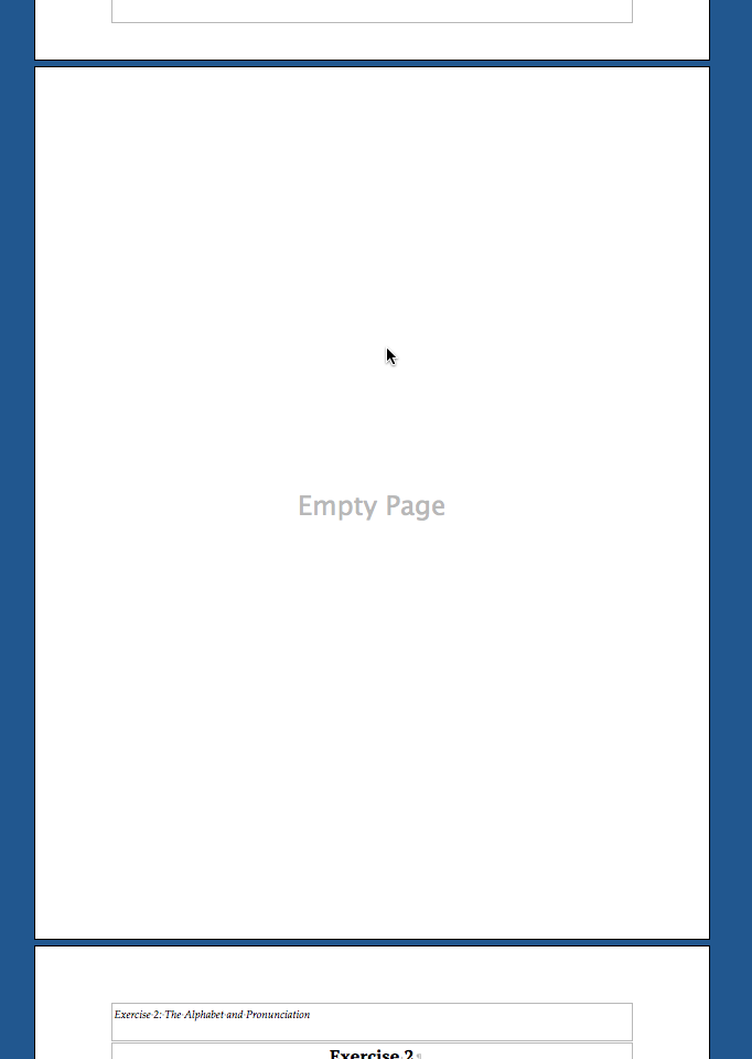

Somehow I got an empty page in my document that does not have a text field. Does anyone know how to delete it?

View > Show Invisibles
This should reveal a Page Break or a Section Break that you can delete.

I did that, but the issue is that there is no text field on the page and hence no place for the page break.

Here is a screen shot

I got it. The section was set to the next EVEN page, hence the jump over the page. Thanks.
