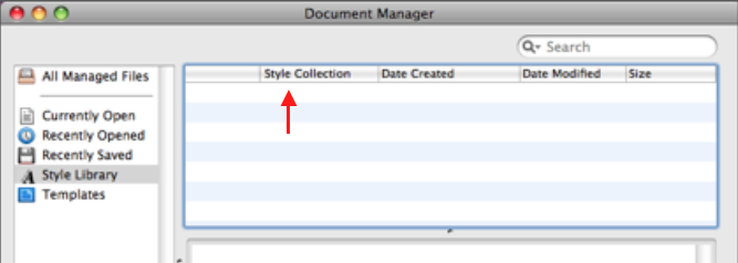

2. Didn't see a way to easily apply custom styles I created. An "MRU" facility that tracks which styles I've recently used and then presents those to me would be good.
You keep track of your styles in Style Libraries (see "Maintain a Style Library" in the Nisus Writer Pro User Guide.) You can save all the styles you need daily in your [1] empty Nisus New File. They are then already "embedded" in all your new future documents and can be accessed right away in the Styles palette, which you can drag around, enlarge and place wherever you want on your screen. Or you can create one or more new [2] Style Libraries for, let's say, each type of document you create: One for novels, another for dramas, another for personal letters and so on.
The [3] Document Manager gives you an overview of all your Style Libraries. Selecting a Style Library in the Document Manager will also show you all the styles that are in that library.
If you right-click on 'Style Collection', you can enable a display-option called "Last Accessed". Clicking on "Last Accessed" will sort your Style Libraries according to this criterion. This should come close to your MRU (= most recently used) feature.
Importing a new style is easy from the Style Sheet View. You can also use the Document Manager to drag a whole Style Library directly into your document, or just the one right style you need.
One thing is important to remember: If you create a custom style, then don't forget to *save* it to a Style Library or to your empty Nisus New File—or to both, for that matter—so you can easily find and use it again later. If you don't do that, then the style will only exist in the document you created it in; and it can be difficult to remember later in which document the style was. However, if it is in a Style Library, then a Content Search in Document Manager can find the libraries in which the style resides. Having found it, you can then easily import or drag it into your active document.
Some Nisus users have only very few basic styles stored in the Nisus New File. They find too many styles in the Styles palette distracting. – After experimenting with several different options, I decided in the end to keep all my styles in the Nisus New File, and I make sure that all new styles I create are saved with a macro into that file. I also keep those styles saved in several Style Libraries, grouped according to document type.
It takes some time to fully figure out how the Document Manager and Style Libraries work, so don't be discouraged. :-)
