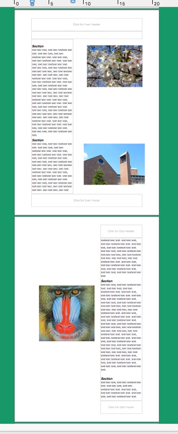

I have a question on how to create a document with two different-sized columns over even and odd pages. Nisus 2.1.6 has the columns are maintained over all pages, not changing from even to odd pages.
For example, on page 1 imagine the different-sized columns, the left column being a 4.19” column and the right column being a 2.25” column. For Page 2, these same sized columns are the same. They don't change when going from odd to even pages.
Instead, I want Page 2 to have the left column being a 2.25” column and the right column being a 4.19” column. So that the pictures are the same size, both on the “inside” towards the book’s gutter, as one has adjacent even and odd facing pages open together.
But I don’t want to create separate sections for each even or odd page. If I did, that would mean I would need to create new sections every page. For a multi-hundred page document, that would mean managing that many sections, which, as you can understand, is intolerable.
What are some solutions?

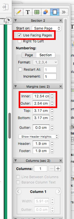

(1) Set the document to Use Facing Pages, move the inner or outer margin as desired to leave yourself room for the images, then insert each image into that empty space. (Text has to be within the margins, but images do not!) If an image requires a caption, you can use the same procedure to insert a text box (from the Insert Shape menu) below the image. This method suffers from a similar disadvantage to the one previously mentioned: you may have to drag images to the right or the left at some stage. The point, though, is that they remain the same size on both odd and even pages.

:arrow: Then it hit me! Why not have 3 columns for the entire section that I wanted left and right pages to be different with pictures placed toward the gutter on the right and left, respectively.
Whenever I wanted to write on the even pages (left side of an open book), I would use column 1 of 2.25”, and just drag the picture to the right (towards the gutter), once I tied it to a paragraph. The picture would be 4” wide. Then, on the next (odd) page, I would just write on the 3rd column of 2.25” and drag the next picture to the left (towards the gutter), once it was tied to the paragraph on the 3rd column. The 2nd column would not be used, so it’s width would be determined by the widths of the 1st and 3rd columns.
Hope my example jpgs are included in this answer.

The attachments you posted are very helpful in showing us the book design you are aiming for. Thanks for that.

weiphotoarts wrote:In this case, Phillip’s caution was appreciated. But his idea of the single column (which I tried) made for lots of work (even with a macro), as it would have to be repeated for every other page (I anticipate my instruction book will have 80% of these.)
Well, I'm glad you found a solution that suits your needs, but I think you misunderstood what I was suggesting. My idea was to set the margins of the single column asymmetrically. After that "Use facing pages" does the rest. So it's actually no work at all. You don't even need to insert column breaks, and you can have text which flows from one page to the next.
Admittedly there is one downside to this approach. Nisus unfortunately limits the header and footer along with the margins. So if you want centered headers or footers over the whole page width, your approach is probably the way to go.

Yes, Philip has demonstrated exactly what we have in mind.
However, although text will flow properly from page to page, images will not. That is to say, if text alteration forces an image to move to another page (specifically, one that is an odd number of pages beyond the original), it may end up overlying text, so it will have to be displaced manually to the left/right. Depending on where the image anchor ends up, the image may also have to be displaced in a vertical direction as well.
