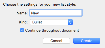

4. A dialog will appear asking you for some initial list style settings. Give the new list style a name and choose a list type, eg: bullet list.

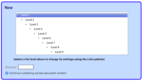

6. If you look to the right hand side, you will see a preview of the list and all its levels. Select the first level so you can customize it:
7. You can now use the Lists palette to customize the selected list level's bullet character. We provide a list of several common characters, but you can type any character you like. You can also use standard formatting actions to modify the bullet's attributes, eg: use the Character palette to change the bullet's font or size, use the Color panel to change the text color, etc. Here's an example showing list bullets with custom character, font, size and indents:
