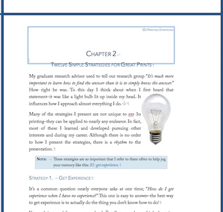

Spoke too soon, now this happens...
- Screen Shot 2017-07-26 at 11.53.10 AM.jpg (52.77 KiB) Viewed 32072 times

G’day, mhackney et al
I notice you have used a soft return (Shift-Return), rather than a normal paragraph return (Return), after the header text. The difference is explained on Page 317 of the Nisus Writer Pro User Guide.
Unlike with a normal paragraph return, the same paragraph formatting obtains on either side of a soft return. This will affect the appearance of line spacing manipulations.
It’s always a good idea to review the CCTV footage from your office camera when you return from a lunch break. The gremlins always seem to strike when you least expect it!
Re: More space above first chapter page Heading
Actually, no I did not do that. I have used soft returns for valid reasons in other pats of my doc but not this header. What you are seeing is a soft return on the TITLE that should be below the header. I use a soft return there so the TOC shows the entire title but yet I get the design I want. Is this a problem?
I assumed you were putting the chapter number and title in the page Header, not below it. The former would be the normal arrangement.
With them inside the Header, regardless of the number of lines (be they separated by soft or hard returns), place a hard return at the end, position the cursor in the now concluding paragraph and then adjust the line spacing.
If you wish the chapter number and title to be below the Header (and hence in the main text body), just create a Style for that paragraph. This would not be a satisfactory arrangement for pages beyond the first, as the position of those details could be affected by text alterations on previous pages (unless you incorporated hard page breaks).
Difficult to see on that attachment, but there should be a hard paragraph return after “3D Printing Strategies”, assuming it too is in the Header.

Thanks. Yes, there is a hard return after the "3D Printing Strategies" in the header (it is in the header).
I had not considered putting the chapter number and title in the header. Is this really common practice? I've not seen that on any of the publishing tips sites I've read. Will content in the Header be picked up in a TOC?
Hmmm, that does present a problem.
It’s actually a very long time since I’ve needed to create a Table of Contents for a long document. But I now see that you can’t reference Header text in a TOC. On the one hand, this is quite reasonable when you consider that a Header can be repeated. On the other hand, it could be argued that the program design should accommodate such an arrangement, by allowing Header content to be marked for TOC inclusion, but with the TOC only referring to the first instance of that Header. One way of achieving this would be to permit text in the Header of the first page of a Section to be incorporated in a TOC. I imagine a macro could handle this.
Be that as it may, you could still use the technique I described to effect your different spacing. It’s just that the chapter title on the first page of a chapter will need to be positioned in the main text body beneath the (largely blank) Header. On subsequent pages the title can go in the Header.

I totally disagree with adryan on the idea of putting a chapter title inside a header, even a non-repeating one. That completely violates the logic of documents. Headers are for information that runs "alongside" the document.mhackney wrote:I had not considered putting the chapter number and title in the header. Is this really common practice? I've not seen that on any of the publishing tips sites I've read. Will content in the Header be picked up in a TOC?
Of course you may want to also put the chapter heading inside the header as well to create a "running header". This can be done with a cross-reference that copies the text. But of course you could also just retype it.
As to why the heading overlaps the header, this should not happen (unless it's a floating text box). It's possible that Nisus momentarily did not update the text layout, which might happen especially on long complex documents with with many elements that affect text layout. Whenever such things happen I would recommend saving the file and then closing and reopening.
