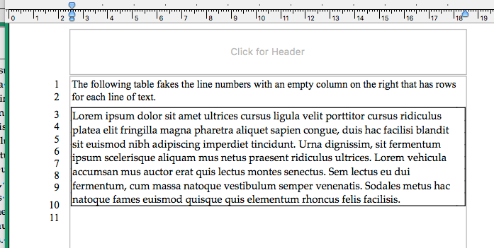

Anyhow, line numbers/paragraph numbers won't number lines/paragraphs inside table rows/cells. One kludgy way to fix that is to add a column to the table that has extra (split) rows:
Table line numbers.png (77.56 KiB) Viewed 32110 times

One small point that might have relevance in some situations is that line numbers can (almost) disappear off the left edge of the page if the Gutter width (available in the Line Numbers Palette) is too large.
As far as Tables are concerned, if one insists on breaking the 37th Law of Word Processing by having Table cell contents occupy more than one line, and yet still wants the luxury of line (as opposed to row) numbers, your idea of a dummy column may well be the best solution. It would be nice to avoid manual counting of the lines in the first place, in order to determine the number of rows required in the dummy column (see below). A quick look at the Macro Language Reference didn’t reveal any obvious way to determine where text within a Table cell will be forced to move to the next line, so I’m none the wiser about a Macro solution.
I considered other approaches, but the disadvantages were too great. For example, one might use Page columns rather than Table columns, but the line numbers then appear adjacent to each column; this approach had other problems as well.
In the end I would probably create a separate Table with one more column (Philip’s dummy column) than the original but with a single row. I’d position this Table alongside the first, so I could compare row and line heights. I’d adjust the height of this row to correspond to the line height of text in the first Table, then add enough rows to suit. Then I’d merge cells where appropriate, it being visually obvious where this needs to be done. Finally, I’d copy and paste from the first Table to the second, delete the first Table, and display the line numbers. It’s all a bit cumbersome, but I guess that’s the price one pays for breaking the law….
