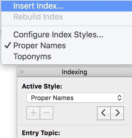

sowers wrote:[...]In frustration, since "rebuild index" did not produce the corrected entries, I deleted the entire index and selected Tools => Index => Insert Index. To my bewilderment, out of several hundred Nisus index entries previously visible in the index, only eleven appeared.
When you apply the Tools => Index => Insert Index command, only the index of the Active Index Style will be inserted. Here, in this example, there is an index of proper names and a separate index of toponyms; Proper Names style is active, so only the index of proper names will be inserted.
Active index style.jpg (42.45 KiB) Viewed 31265 times
It may be that the eleven entries that appeared were made with a different index style which was active when the Tools => Index => Insert Index command was applied.

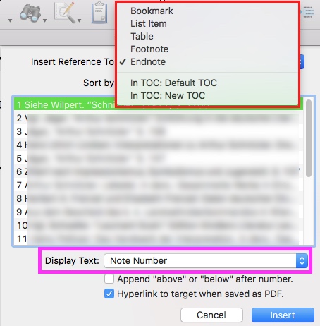

If you end up with the endnotes twice, why is this then more convenient?
Just select all the endnotes and create a cross-reference at the location where you want the endnotes to appear.
Since this is impossible, I'm sure you must have had something else in mind that is not mentioned in the description above. Could you give a step-by-step instruction?
And how should the Cross-reference pane look like?
As you can see, the only thing that can be referenced is the note number, not the endnote text(s), and that means, having to select each and every endnote, one after the other, in order to be able to reference all the endnote numbers. I guess you must have had something else in mind than this, but I'm clueless…
