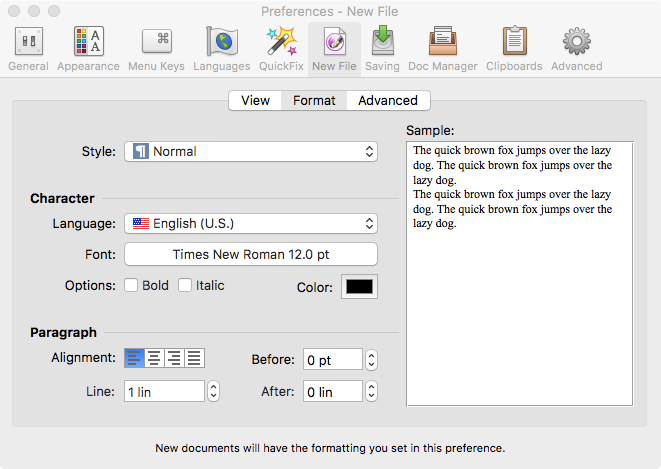

To redefine the NIsus New File I think you should use the NIsus Preferences.
  • Go to "Nisus Writer Pro > Preferences > New File"
  • Choose the "Format" tab. This should look like this:
  • Choose the "Normal" style
  • Set the font as you would like

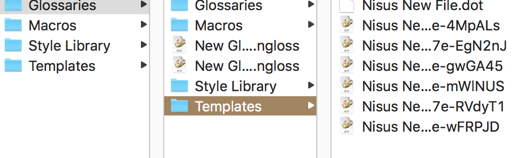

Thank you very much for your answers to both of you. All this I had already done more than once. What is very troubling is the number of files this creates in the Nisus Project Folder, some of them are to be found in Nisus Project/Glossaries/Templates (yes. . .) like this:
Screen Shot 2018-08-11 at 09.10.49.png (98.96 KiB) Viewed 14770 times
and some other in the Nisus Project/Templates. I just have done a New Fils again and it appears there, but besides some strange new other templates named : Nisus New File.dot.sb-a5627702-HNcyqR.

Things have indeed gone astray with your file locations. I would suggest you reconstruct the Document Manager from scratch.
It seems that all the folders in your screenshot are contained in a folder you have named Nisus Project. I suggest you first save a copy of this folder in a safe place, just in case of mishap.
The default location of the Document Manager files is in a folder called Nisus Documents inside your (main) Documents folder. You should be able to change the name and location of this Nisus Documents folder, but I would tend to stick with the default arrangement, at least until you have everything working properly.
You want the following arrangement:–
Users > (your main Home folder) > Documents > Nisus Documents
Within this last folder you want the following folders:–
Glossaries
Macros
Style Library
Templates
You do in fact have this arrangement in the leftmost pane of your screenshot, but somehow you have got similarly named folders located inside the topmost Glossaries folder. It is not clear how deeply some folders may be nested.
I would create four new empty folders as suggested above. Then transfer files and/or folders from your Nisus Project folder to these new folders as appropriate. (For example, the Macros folder will contain a number of subfolders.) With the possible exception of the Macros folder, work with the contents of folders rather than with the folders themselves. For example, you would not want to drag the Glossaries folder from the middle pane into the leftmost pane and choose to replace the latter with the former! Look inside the folders, just in case your have further nesting. Be careful when resolving duplicates: you usually want the latest versions. Only put one Nisus New File.dot file in your new Templates folder.
Having rationalized your folder structure, work through the Nisus Writer Preferences panes and make sure all locations there (eg, for Document Manager and Nisus New File) correspond to your new folder structure.
Now quit Nisus Writer and restart your computer, just so they can contemplate the error of their ways. Then launch Nisus Writer, open a New file, and make sure your Nisus New File template is set up the way you want it (with styles and such).
Things should now work properly. If they don’t, consider trashing Nisus Preferences (and relaunching the application) and/or reinstalling Nisus Writer.
There remains the question of how your folder structure got messed up in the first place. I’m afraid I can’t think of an obvious answer to this. If the problem recurs, despite the measures suggested in the previous paragraph, try using Onyx to give your system a good clean-out. If that fails, you may need to consider reinstalling your operating system.

I just found that there are three Templates folders in three folders within my Nisus Project main folder […] Should I erase some ?
Your folder structure is mixed up, and that seems to be causing the problem. The good news is, this isn't hard to fix. If we had more screenshots from you, we might be able to fix this right away. But we don't, so I suggest you do the following:
1) If you have a Time Machine backup, you could go back in time until the day you installed Nisus for the first time. That would show you the original folder structure. While still in Time Machine, you could click on the Restore button and, when asked, make sure you click on *keep both*. That would restore the original folder structure, while keeping your present folders in tact. You could then in Finder manually replace the new files with your old ones. This requires that you know how to use Time Machine and are comfortable with working in Finder.
2) Or you copy all your Nisus stuff to a USB-stick before you delete all traces of it from your hard disk. Then reinstall the application and carefully add your old files to the new folders.
Maybe your problem started when you were playing with the Document Manager and things got out of control somehow. I strongly recommend NOT to use the Document Manager in the beginning. Use the Finder instead to organize your files. Don't use the Document Manager until everything is running smoothly and you have become more experienced as a Nisus user. There are users, by the way, who never use the Document Manager.

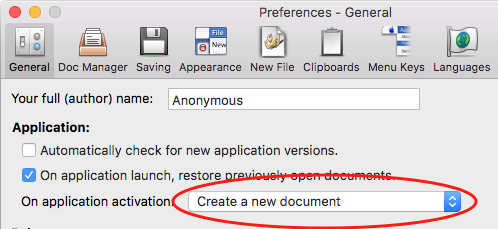

Is there a way of having this Nisus New File opening when opening Nisus Pro? Right now I get something akin to the template, but with some other specifications.
Yes, assuming the folder structure has been fixed. See screenshot below.
