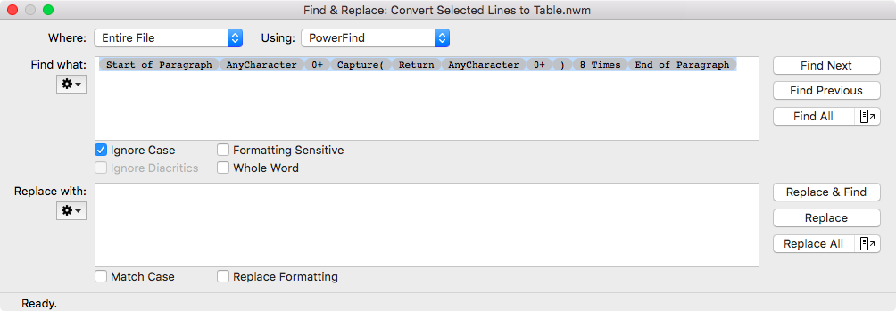

The crucial line of the macro is the one which selects N lines of text, excluding the last return. For example if you want 9 columns you have 9 lines of text with 8 returns. So the find expression will need to select 1 line followed by 8 repetitions of <return><line-of-text>. In Powerfind the expression will look like this:
In Powerfind Pro the same looks like this:
Find '^.*(\n.*){8}$', 'Eas'
Finally to get this to work with a user input, one will need to replace the "8" with a variable that can interpolate the desired number. I've used $c for the variable. For interpolation to work it is necessary to replace the single quotes with double quotes. But this in turn means that the backslash and $-sign need to be protected:
Find "^.*(\\n.*){$c}$$", 'Eas'
